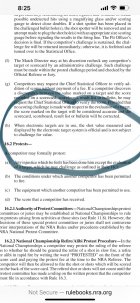

The ShotMarker System is a great innovation that is being used more and more. Occasionally, an unexplainable flier shows up. I’ve had it happen to me! The shot can’t be explained as a crossfire, unusual speed, angle, etc.
As a match director, it would be nice to have a set of rules for disputes. The only rules I’ve seen is you take what you get period. Any suggestions would be appreciated.

I’m also a shot marker MD, for monthly midrange matches. We have had no-reads but we have not seen a truly aberrant placement of a shot, yet. I can say that if Shotmarker lacks a certain degree of confidence in the placement, it can show it as a ghost shot.
The unexpected placement of a shot that was actually made by the correct shooter should be accepted as valid unless that target were to be in the process of proving that it is faulty. If that were to occur, and I have not seen it, then it would likely be consistent and I would look to see if I could allow the reshooting of the problematic scores.

I have had shots like that on paper with pit pullers and blamed it on the pit pullers but it was probably me or my ammo which is also me. I have also experienced it with ETs and have to assume it was me also. By rule I have no other choice and I am willing to accept that to gain the other advantages of the ET.
There is one other point that I will make. If you look at pictures of shock waves in a good aerodynamic book you will see that as the Mach number drops from supersonic to subsonic, it transitions from a well defined cone to a very oblique bow wave. In the transonic region from Mach 0.8 to 1.2 it gets very messy, and I think that can be a problem for the ET. I am amazed that they do as well as they do in the range of Mach numbers that we use them in. I would strive to keep the velocity up as much as feasible on the target.

Those mystery shots 99% of the time are on the shooter, they just don’t want to admit it.
If targets do have an issue it is when next door targets fire right at the same time, but as said earlier shotmarkers can show “ghost” shots.
Several times I have seen shooters lose their mind about an 8,7,etc in target. That can’t be, etc. then go down to pits and imagine that, shot right where they didn’t believe it to be.
