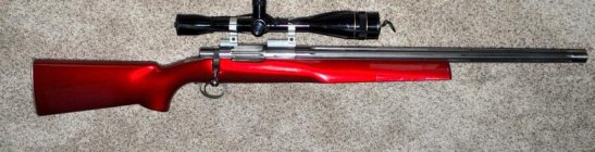

10/30/23 shooting think I have this gun about where I want it . 6mmBR , 31gr Varget , 65 Gr Dlablos bullets . Hall action and rechambered Broughtion barrel. Next time I'll try score shoot with one shot at each dot . Reason for two targets is different size target dots .

Yep looks like you bout got her in tune no doubt.

Isn’t your math incorrect on your measurements? I see you are deducting 0.224” instead of 0.243” because you are shooting a 6mm BR correct? If so your groups are actually smaller than your measurements
No , I measured a single hole in the target and it was .224 or .226 even with a 6mm bullet so I used the .224 to subtract from the 243 bullets . I think that is the right way to do it . A 6 mm ( .243) bullet will not punch a .243 hole in the paper .
So my .150 group is really .131 ?

The barrel is a 6BR , rechambered Broughton 1:9 with a no turn neck of .272 and legnth of 24" . And I'm into the rifling .005 or just touching . I was fire forming the brass that I full length sized for the rechamber barrel . And shooting 65 gr bullets at around 2940 fps
I first said it was a 1:8 but it is a 1:9 .
