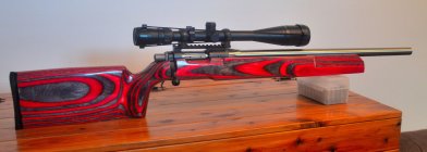

This is the gun the stock has every action of every gun I own in it A kelby , a Hall , a ranger arms and two different Remington . and now a XP100 with a Urbanrifleman Wilson barrel . Scope is a old B&L 6-24 power .
I changed the bolt handle fluted the bolt and put a lever type bolt release on the other side . And trued the action . And I need to make a new trigger guard for this action .
