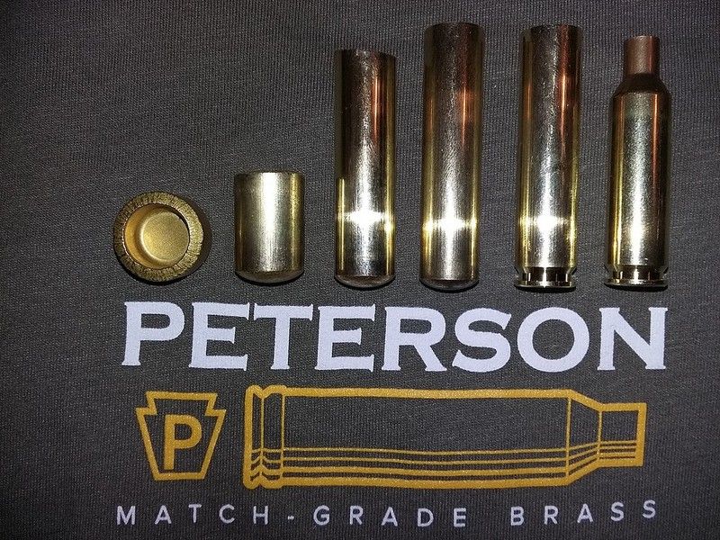

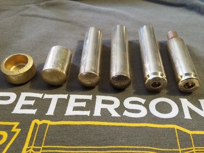

Below is the step in making their brass start to finish.
Terry
