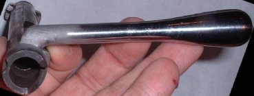

I welded this long, home made bolt handle on a VZ24 when I was building a 300 Win mag.

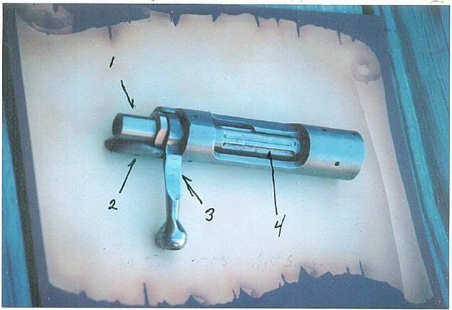

I welded this home made bolt handle on my XP bolt. I cut the bolt handle at errow 3 and welded my bolt handle on it and it never come unsoldered.
