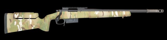

Funny, I got the urge to put together a short-barreled .308 on a Win Model 70 post-64 to just go out and shoot for fun last Spring. Barrel is 1-12" twist, 24 inch, and shoots the 185 Juggernauts out of a Palma-95 chamber, squeaks in at 1/2 min.
Also, I've concluded that a short barreled .308 just is not that much fun to shoot anymore...maybe if I wore a jacket? (And YES, it is available!)
