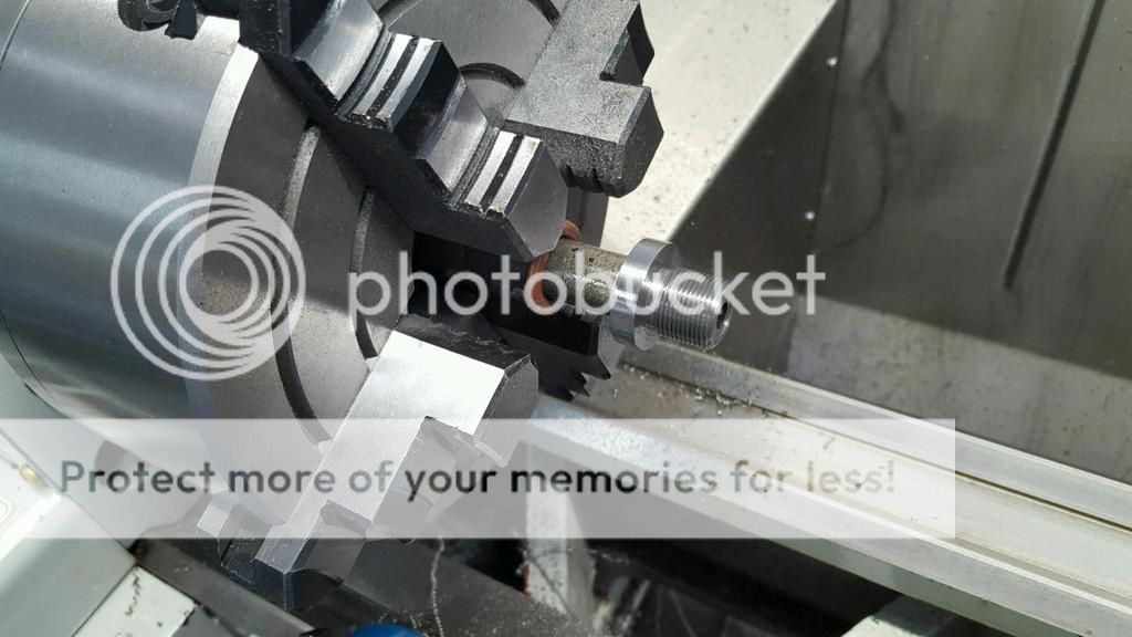

Alf, I'm getting that 20" cut to 16" right now and threading it for a suppressor. It will put down coyotes drt. I'll guarantee it!
