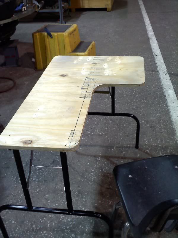

I just stuck this one together at work the other night. Took Martins plans and modified them a little.Still need to cover it.
I tried three legs out in Kansas last year and I was very disappointed. In the wind it would shake and I couldn't keep the scope on the dogs.
Tripods are always more stable than quadpods...........Surveying equipment, cameras, telescopes.........If you need it stable, you need three legs.

ShaneG, you cut your "cutout" on the wrong side..... ::) ;D
Rod
I was wanting to say that also....... ;D
I've built at least 5 myself. The last one I ended up with no cutout, and it sits in my living room for mounting scopes and such.
The bonus of being single........... 8)
