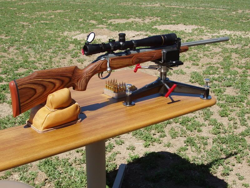

Phil - It's in 204 Ruger. One of the very first M75 Varmints to be delivered to the U.S. in '06. The thing thrives on RL-10X and both the 32 & 39 SBK and shoots in the .3's. Many, many ground squirrel has been launched with this rig. It's scoped with a Leupold VX3 6.5-20X LR with the VHR reticle and M1 factory elevation adjustment. The factory set trigger is one of the best I've ever used.
I just wish it had a standard box mag instead of the detachable version, as we shoot single shot from the bench to allow barrel cooling between shots, and that mag setup is a pain, otherwise a great shooting Sako. :)
I use a pedestal and a protector bag at the range and a swiveling Harris bipod and a squeezable bag when dog shooting. I find with the bipod and squeezable bag its much easier to line up on dogs with varying elevations, angles, etc. If the bench isn't long enough to accommodate the bipod a heavy sandbag in the front fits the bill nicely.
I have two set-ups, besides a bipod. I use a Hart table with a Bald Eagle slingshot front rest and bunny ear bag on rear for a table set-up and I also use a McFadden Machine Inc Ultimate Tripod, which is fantastic and stable.

I am the OP and have decided to try the following arrangement. I found a used Shadetree Engineering co-axial top, which is mounted to a Caldwell Rock BR heavy rest. The Shadetree top has a 3" wide Edgewood bag, and I also have another bag for rounded fore end rifles. In the deal, I also got a bag rider system by Evolution Gun Works for the AR15, and a Sinclair front bag rider for my bolt gun. All this along with a Protektor rear bag and heavy sand, should allow the gun to be rock solid along with easy aiming using the co-ax unit. Now, lugging all this stuff to the bench!
I did try a hefty Dog-Gone-Good bag and it was impressively solid. It surprised me. But, it was fairly heavy and bulky and felt I could do as well with the mechanical front co-axial rest.
