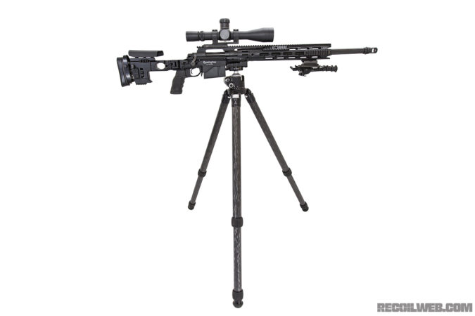

I've been using a pair of shooting sticks for quite a long time. They're effective enough if I'm seated, but I find them unusable standing (beyond very short range). I also have a bipod, but frankly - I've never been in terrain that would let me use them.
I'm looking for something that will provide a fairly stable shooting platform. I don't know if that's a tripod with some sort of attachment or some other system. I expect some level of setup time. I don't like snapshot situations, so I try to put myself in position to have time to get myself situated, though that's not always possible I guess.
Any thoughts?

I've used this system for the last couple of years and it is the best in my opinion. You inlet the adapter into the stock and off you go. Super comfortable to shoot. Expensive? You bet! but far more useful than other solutions.

Yeah, this is top of my list. I was hoping someone would mention it with personal experience, thanks!

RRS if you care about the best weight/stability combination/compromise
Just pick the one that has the weight you want
if you don’t mind buying Chinese then there are plenty of leofoto options that are basically Blatant knockoffs of rrs Products
I’m more of a leveling base guy and the RRS TA-3 is what I have and I like it a lot
the leofoto yb-75 is the Chinese knockoff leveling base

Benro TMA48CXL + RRS Anvil 30 + (ARCA rail or Ingenuity Rail on your rifle... you pick your preference) is what you want Jay. You can spend more, but it'd be tough to get more solid for the packing weight.
