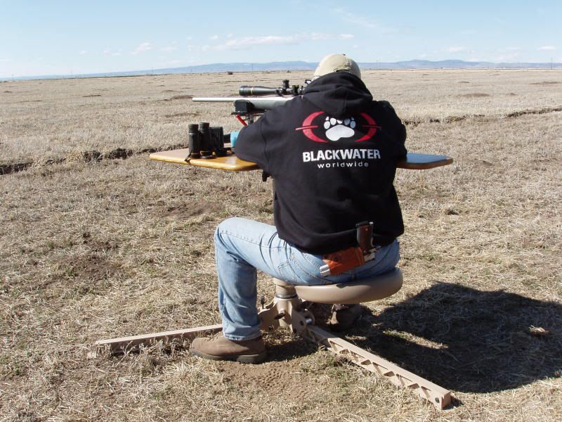

Wow, imagine my surprise when being new here, I logged onto this thread and saw MY OWN photo on the lead post by the Forum Boss. I didn't even know I was "here". ;D
Anyway, being a bit biased, I'll say that I've been using my two BR Pivot Lite benches now for 14 years, both benches are still going strong. When I sold my U.S. Patent and the manufacturing rights to Battenfield Technoligies/Caldwell for the BR Pivot, it was no longer available as a Lite, all-alloy version. It is still in production by Caldwell, but is mostly all-steel now.
A bit older than "me" in the lead photo, but still sending PD's, rock chucks and ground squirrels to the Big Alfalfa Patch in the Sky:

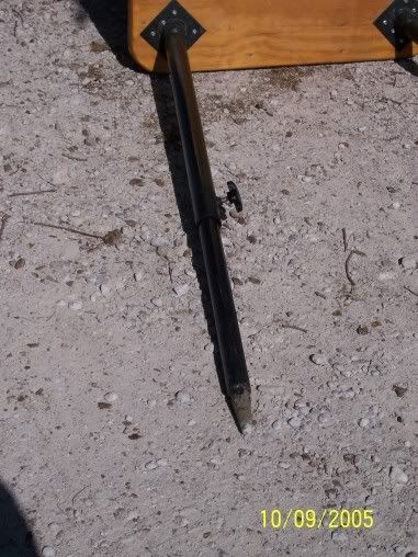

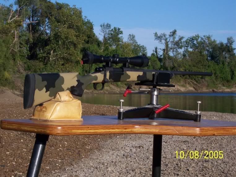

Here is one I built which works well. It is very stable and has adjustable legs so you can level it anywhere and also raise it high enough to shoot off of while standing.
Does any one know where these type of adjustable table legs can be purchased ?
Nice benches, but every bench I've used where the whole top swivels is just not stable enough. I've gone as far as using the front hub from a car with the disc brake attached and a hand lever to disengage the brake to rotate the top. Still way too wobbly to shoot long distances accuratly.
