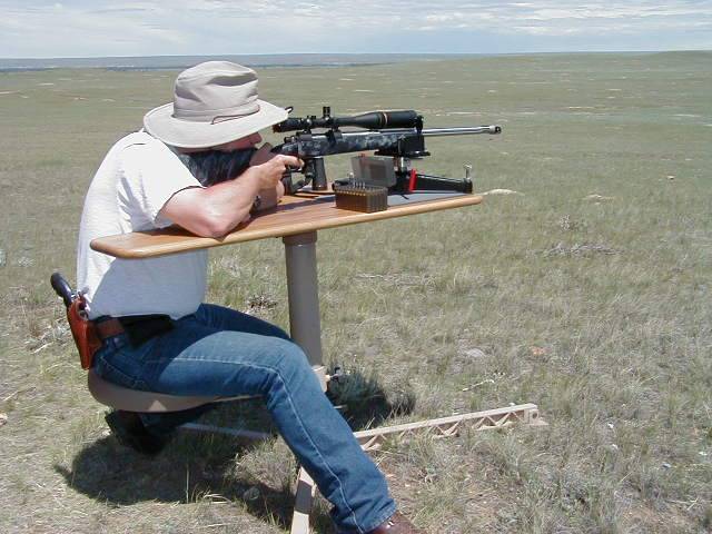

That 'simple' Caldwell bench is their 'Stable Table', which is the el cheapo/simplified version of the BR Pivot. When I sold the patent and mfg rights to them, we told them the silly little plastic bench top was inadequate and more room was needed. They failed to listen.
We had more than enough room on the original design as shown here during a PD trip in MT. There's enough room for a Barrett .50 cal rifle, so most any normal rifle used for field shooting has plenty of room, plus enough room for the shooter's arm/elbow. (The original BRP was used in the Green Zone in Iraq against insurgents using the Barrett .50 cal.) In the pic, I'm shooting my Holland built .243 Ackley V-Block M700/Pac'Nor rifle, scored a second shot hit at 841 yds.
One caveat on putting a boat seat w/back or similar on these benches is the potential for tipping over, due to leaning back carelessly when not positioned directly over one of the three legs. Seen it myself in the field. Best not to modify some things that are not 'broken'. JME
Rick what did you make the top out of? Don’t suppose you have dimensions? I love the longer elbo side
Fern, the original BRP bench tops were constructed from furniture-grade edge-glued white oak by a mill in western OR (butcher block style). My buddy owns the mill and is also a rabid rat shooter, along with his gunsmith son. The top flips for RH/LH shooters.
Going from memory, as my bench is all packed up for the season in the garage, the length from front to rear runs right at 46"; plenty of room for rifle, rest, bags, trigger arm and elbow. If you want/need complete dim's, I'll have to unpack my bench to measure accurately.
The pic below shows how wide the bench top is from a rat shoot this year. Our buddy Allen who owns the bench is a RH shooter, and his bench is so configured.
Yours truly shooting rats this year from my personal BRP Lite. Plenty of trigger arm room and elbow landing area as one can see.
Hopefully, you'll be able to reverse engineer a top from the photos for your new bench top. Let me know if you need more detailed intel.
