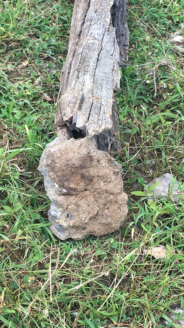

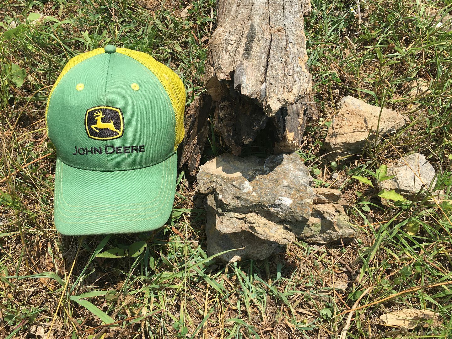

I hiked over to the 2000 yard spot and stood a rock up so I would be sure to know if I hit it.
I took 5 shots with the Cheytac and every shot was close. I let Junebug try and on his second shot (#7 total) the rock was broken by the 350 gr bullet.
Junebug and I hiked over and Bug packed the rock fragments out and gorilla glued it back together for a memory. Looks like impact was just below center.
