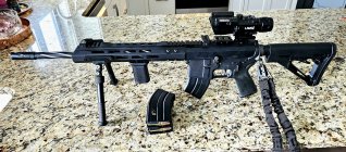

Recently put together an AR47 with a side charging upper receiver and was wondering if any of you have input or experience with shooting standard 30 cal (.308" diameter) bullets in a 7.62x39 barrel (.310"-.312" diameter)? Looking to go with 120-150gr bullets. I will slug the barrel sometime this weekend to see where I'm at on actual bore diameter because I know things can vary, but just wondering what your personal results have been for accuracy and the load recipe you used. Thanks.
