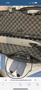

I am planning on shipping a rifle in a gun case. Do you think a rifle case like this and a benchrest rifle is okay to ship as is.... only reason I'm asking is it is a lil compressed. It's not bad it will close without a lot of resistance..
I just don't want it damaged.

I tape a length of foam pipe insulation around the barrel with an extra 3-4 inches past the end. I’ve received guns where the barrel punched thru the case. ALWAYS pack the bolt separately , out of the gun, in foam or bubble wrap.
I plan on definitely bubble wrapping the bolt separately. I have a additional barrel to ship with it but I can put it in the box outside the case..
I'll be putting the case inside a box...I'll tape the barrel case so it doesn't move as much..

I would put it in that case then put the case in a larger heavy cardboard box with some serious packing. I would put some packing inside the black case to insure it does not move to either end of the gun case. and I would not be worried about getting the black case to close. it will be sort of an inner protection for the main package. I would tape the black plastic case semi closed. the key IMO is to secure the rifle inside the black case w lots of packing and go from there. you also have to be careful the styrofoam does not make mark on the finish because it will do that guaranteed!! wrap in soft cloth inside black case.
Never ship it without the rifle case in a cardboard box. You don't want it to look like a rifle case at all. I have film canasters 1/2 full of hard rubber to tape on to the muzzle then if they bounce it on the muzzle end it won't hurt the crown. For sure put the bolt in bubble wrap and place it under the muzzle end for more room under the barrel. Whoops, not through yet. I use 2" mono tape and wrap completely around the plastic case at and over each case latch ( including the case handle) . Insure it for what it's worth and let er rip. Has always worked for me after every mistake in the book.
I shipped a rifle and extra barrel and put the rifle in a rifle case that looks like the one you plan on using. Bolt was separated, and extra barrel left in the tube it came in. Barrel was outside the cased rifle and all were in a very large heavy cardboard box. It was almost 70# and got to Texas in good shape. I used 2 large packages of shipping paper plus a small one from Walmart to pad the cased rifle and barrel inside the box.
Place some id inside the rifle case. Zip tie shut. Use stretch wrap to tie the extra barrel to the rifle case. Make sure nothing can move inside the package. Stretch wrap is very usefull inside packages to tie things together so they cant move.

I plan on zip tying the case on each end ... to ensure it doesn't come open.... I'm just trying to get some ideas so I can ensure the individual gets a unbroken rifle lol I don't trust our shipping service from any company
I shipped a gun but used a Pelican 1750 or 1720 case with 4 matching locks (single key) with no box. Arrived in great condition with no damage at all and used the USPS, I walked in carrying it and a couple of guys just started laughing, they knew what was in the case!! PO was no problem.
Invest in a better case, I have the same case and only use it to take the rifle in the truck on a short trip. The type of latches on that case are a POS. The case is very flimsy and not made for heavy duty use that baggage handlers give it. There are better cases on the market.
