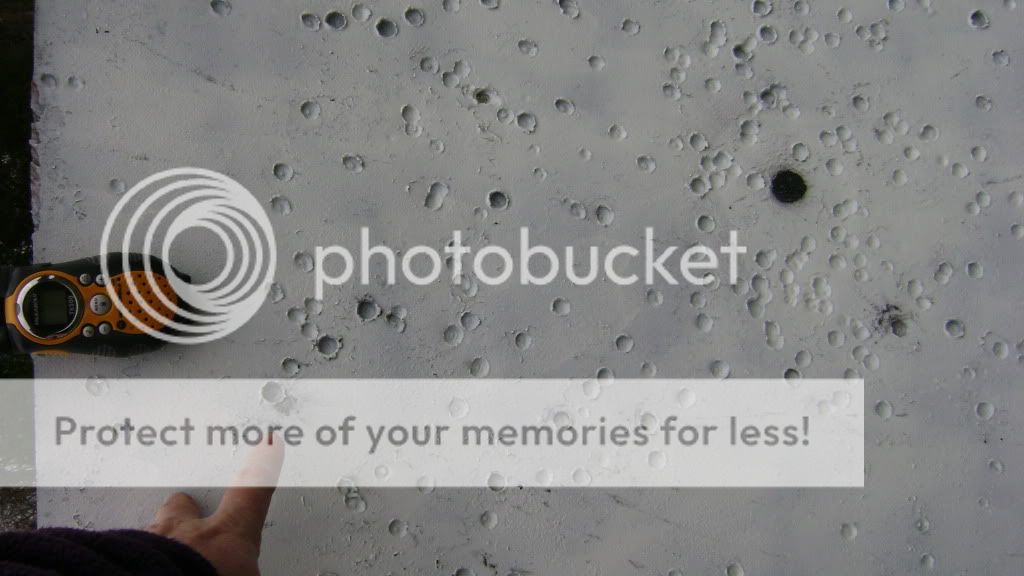

Junebug came over this p.m. and spotted for me using
his March 10x60x. It was cloudy and dark. The March
was perfect for spotting. We shot first at a bare spot of
ground at 1700 yds and got her dialed in. Then I dialed
in four more MOA and went to the 1760 yd 4' x 4' plate
Bug saw a shot throw dirt and grass just off to the left and
slightly high. Made an adjustment and fired another round.
Just as Junebug started to say you have a hit, we both heard
a very faint DING as bullet contacted metal at one mile.
I fired again and Junebug said I was a little high and I was
dissapointed. But he said no, you have another hit slightly
higher ON TARGET. Now I felt better with two consecutive hits.
But then I made a mistake and told Bug to take the Gator over
and paint me a larger bullseye and spot from the target using the
walkie-talkies. His angle from the side made it impossible to call
my hits. Next time I will keep him with me spotting with the March.
But I did get two hits in a row shooting blindly, using only info
from my spotter. Junebug, you can spot for me anyday.
Bug did as good a job as Voldoc and JR spotting for me in the
prarie dog wars.
Group was all vertical. Almost no windage.
Bullseye was the round one inch black spot.
One low left,
One high left.
Approximately 18 in group.
Walkie-talkie hanging from top of plate
Easier to see in this horizontal pic
