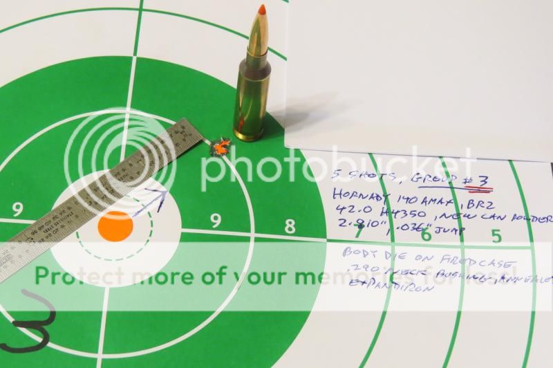

Here are the groups I shot yesterday with my 6.5 Creedmoor;
The 3/8" group next to the dime, and the 1/2" group on the right, are more normal for me then is the "bug hole" group in the top photo. And it is these 3/8" to 1/2" 5 shot groups is what I'm looking to produce again consistantly with my next rifle.

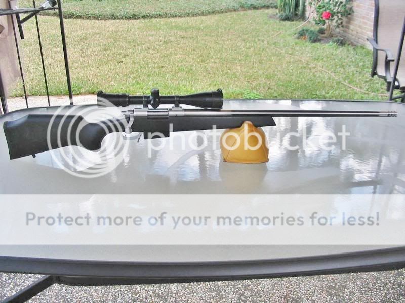

Here is the 6.5CM rifle that shot these groups. I custom made the stock to fit the fluted Brux barrel, and to accept a DM;
In an earlier post, I described my rifles as "varmint/police rigs". This rifle is not a bechrest rifle, and the Remington action is not blueprinted. While I'm not seeking competition groups in the 1's or 2's, I hope I can at least have the satisfaction of knowing that my rifles are a notch or two above the guns a couple of guys are suggesting I buy off the shelf at a store. I normally incorporate a jewel trigger, pillar bedding, and a flat bottom stock into my rigs for accuracy, as you see here;
Nice job on the stock. For the accuracy you are seeking, most common calibers will suite you. Lately I have been wanting a 6.5x47L, why? I don't know, I just kinda want one.
If you want to try a slightly unique wildcat cartridge, then perhaps the 30HBR (Hunter Benchrest). The 30 HBR is a full-length 308 Win. with a 30° shoulder and less body taper than standard 308 Win. And as one member mentioned, you have Lapua brass to use in small or large rifle primer.
Cut the guy some slack. He could have been testing loads and didn't want to jack with the dope for his primary load. The gun might be a field rifle and the sling swivels may serve a purpose. Not everyone shoots free recoil and worries about tracking.
lawman29 said:
precise groups shot inaccurately.....
p.s. take the sling studs off.
Not that I shoot free recoil, but I do always take the front sling stud off at the range, feed cartridges into the chamber singly by hand, and flip up the scope covers so I can see through the scope. I also prefer to leave the shaky glass patio table at home and use the bench provided at the range. But, thanks for the compliment.
