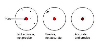

The question seems to confuse accuracy and precision, the two are not the same, and the answer varies with application.
Never hurts to remind folks of the difference between accuracy and precision. Frankly, with the advent of scopes and turret knobs, the term "accuracy" no longer means much on a scoped rifle.
