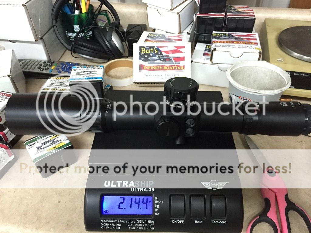

Has anyone tried the 12x52 VALDADA IOR TERMINATOR with a 40MM tube? The 36s are phenomenal. I've been offered the opportunity to give one a try. It's an impressive looking and feeling piece of equipment. Can't wait to try it out.
Bart
