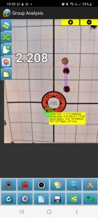

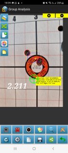

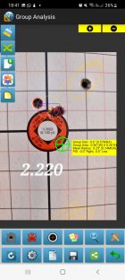

I've been handloading for about a year now and I want to choose seating depths that gives me room as the thoat erodes
I test 142 gr SMK with N555 (43.3gr) at a few seating depths (6.5 creed)
I have a few of the pics and a graph to show the groups vs cbto
Im leaning toward the cbto of 2.211
All shots are unmarked (3 shot groups)

Your pictures are inconclusive, IMO.
Shoot at least three groups per load.
If all three groups of the same load print differently, that will tell you that you need to focus on your shooting technique or platform.
If you manage to get three very similar looking groups from the same load, your technique and platform are consistent enough to show seating depth variation on the target.
It's not possible to identify a good group before you can shoot consistently good groups.
Im not the greatest shot out there , but 3 x 3 groups are a waste of components IMO

Based on group size I assume it's a hunting rifle. I would pick the best load you can shoot now and if the groups get bigger after 500-1000 shots, then worry about it. I would think the powder type and bullet are the big things to determine group size in your rifle. I don't think the groups are small enough or consistent enough to evaluate seating depth. My varmint rifles shoot under ½” groups and I cannot see obvious differences from seating depth. I would think you would need to consistently shoot groups around 1/4" to have a chance at seeing seating depth changes. How much of your group appearance is due to bench manners and shooting skill? It’s a mistake to think the group is just determined just by the load. Many of us are not exceptional shooters with great rifles. I see a lot of guys testing loads at the range with no flags.
Ok, I’ll just ask, what kind of rifle are you shooting? Can we see a picture of it and the support you are using front and rear?
Those SMK bullets are capable of shooting much tighter than that, but they are long and need stabilization. It’s a big picture issue affecting your group size.
Moe, your groups are much smaller than 3x3. The small square are .5 inch. Your groups are actually at the 1.5” accuracy guarantee of sone very good, and expensive factory rifles. But those 142’s, a go-to in the early days of Fclass, could easily all touch or overlap on a .284 case (+ ~5 grains)) with a fast twist barrel and a heavy gun, which is the reason for the question.
The 2.211 group is 0.7"
The 2.220 group is 0.6"
