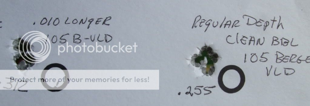

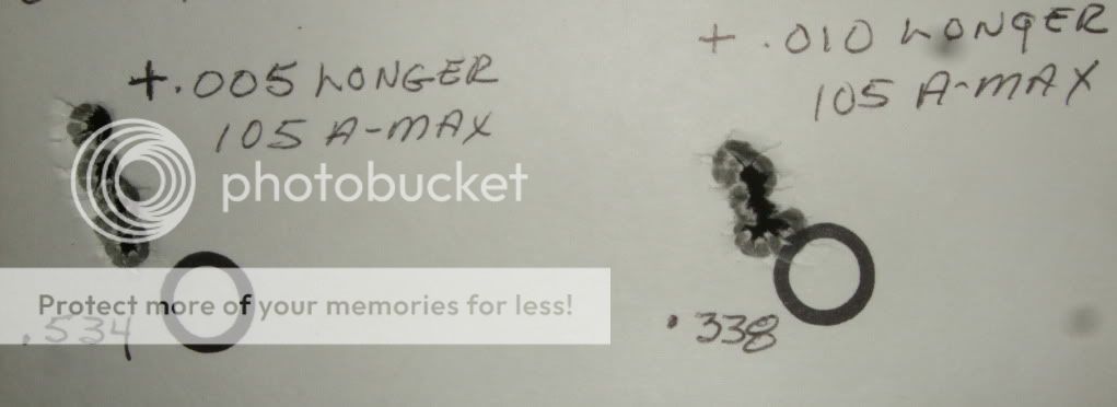

You can bet it will make a difference, but as the twin mentioned they are all different in there particular wants. These were from my 6mm SLR while working up loads...
Regular depth is with the thickest base of the bullet at the base of the neck, and I work out from there.
The 105 A-max needs a bit more work, but it's coming around..
The 105 Bergers are doing good, but will keep on checking..
All are about .0015 neck tension...

I see a lot of vertical in those groups. Try changing your load in .2 of a grain increments. Going from in, to out of tune, can usually be resolved within a .6 of a grain range.
