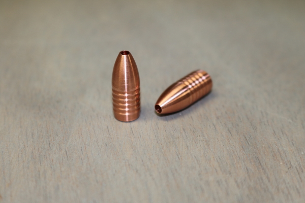

If you have a real need for (30 cal) speed, try these:
I used their 124gr version in a .308Win just for laughs.
