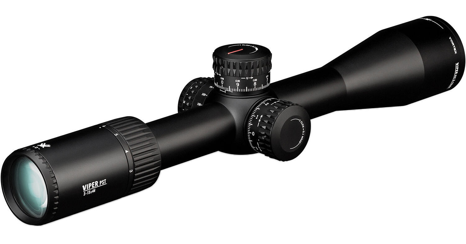

I like my Vortex Viper PST Gen II in 3-15 x 44 and they can be had under $1K illuminated and of course comes with Vortex's bullet proof warranty.
You can google other sources for this scope, but here is an example of a retailer with various reticles and pricing
