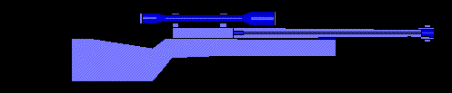

From Varmint Al's website:
6PPC - distortions amplified 500X (of a dynamic response analysis)
Even though an animation at 500X, this is why scopes are acceptable to POI shift.
There is a lot more to it then just rigidity of mounts and rings.
But does represent well why I desire wide ring-spacing.
