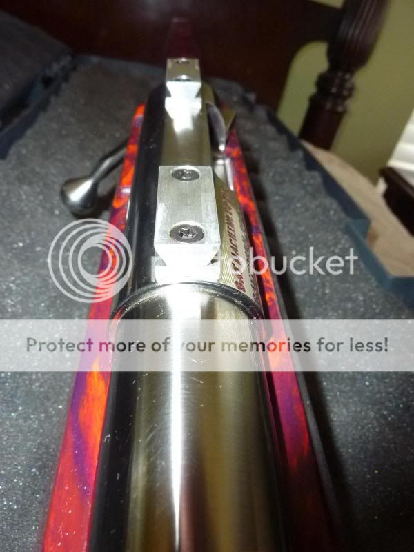

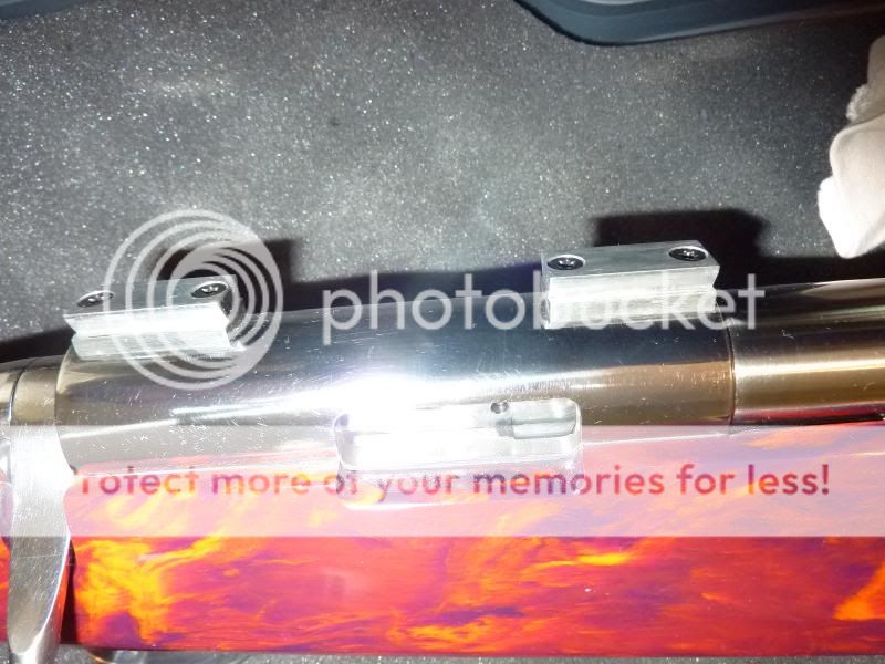

Anyone recognize these bases? wondering if these bases are okay to use for bench rest shooting? If so, any thoughts on rings to use with them? I don't have any lapping tools so I was hoping to find rings that would work without that step...but, I don't want to sacrifice accuracy/consistency either so just tell me the right thing to do please. The scope going on a is a 1" Weaver T36x40...Thanks
They look like Stolle/Kelbly Dovetail Bases, at a guess without a measurement.
Maybe Kelbly Rings to suit.
Hard to tell without dimensions, but they look like Davidson-style bases, in which case you could use Kelbly rings or other manufacturers who make a ring to fit that style base.
Similar to these by PMA tool:
I thought most of the dovetail were just like the olld unertyl bases and kelbly rings,jewell rings,etc etc etc etc all fit.
Assuming I can use Kelbly rings, any suggestions on the height needed? I believe Kelbly has 2 sizes a 1.1ish(short) and a 1.5ish(tall) to center of scope.
