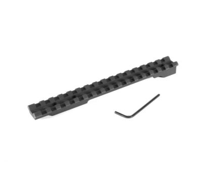

If it still has the Hump on the rear bridge and 3 holes, A military mauser 98 mount will fit. EGW makes a pretty nice one that's reasonable.

Go to Ken Farrell's website and you should be able to see his hole spacing for Mauser variants, But I would venture to guess that this rifle had a two piece base system on it for which any of the scope base folks like Leupold or Burris etc would have what you need.
