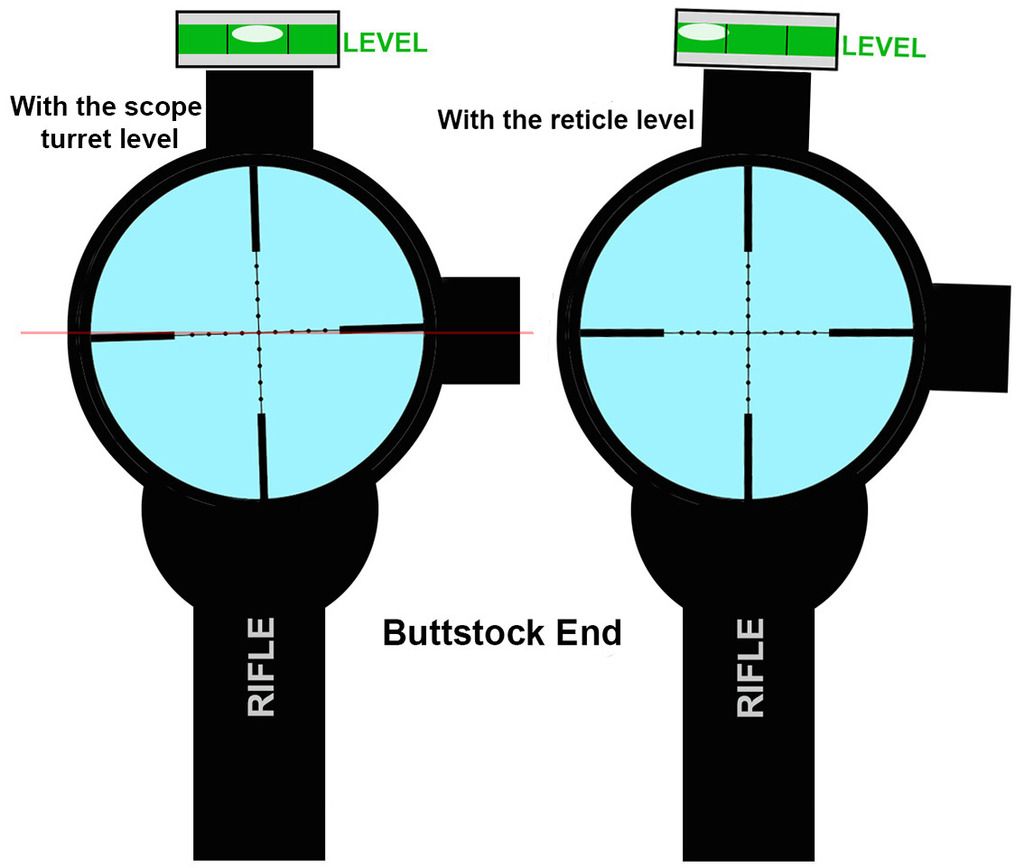

I did use the tool shown above to get the scope and barrel centerlines vertical and then put a weight on a small piece of rope outside against my garage and adjusted my vertical reticle line to it. On my SWFA scope it was 99% even with the top turret cap. I've seen others that were off. I always use a bubble level on the scope when shooting so that I'm holding the rifle correctly. At distance, if it is canted the point of impact will move left or right, especially when adjusting the elevation.
I will share my "worst case" I have experienced. On a BSA scope with the reticle plumb. I sent the 2 scopes back to BSA and they sent them back and said they were within spec. I know, cheap scopes.
My worst was also a BSA. This is the drawing I sent in with the scope. It was well over a year old. They sent me a new one. It was a 1x4 (30mm tube) and I had it on an AR. I assumed it was made correctly and until I pulled it off to put on another rifle and looked through it, I never noticed.
