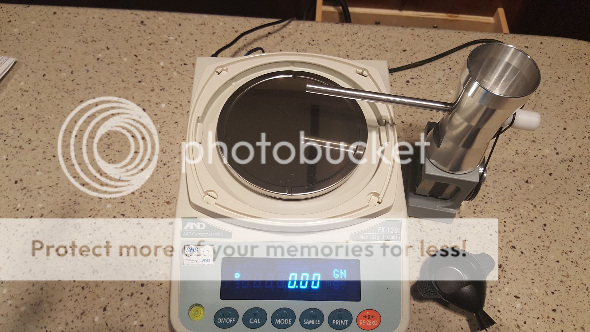

Sold my chargemaster. Here is my new.setup
I could never warm up to the charge master at all.
The aitotrickler and the fx120i I just got and is an awesome set up. It's very accurate. I prefer to scoop some powder in the pan as it's trickling.

Get the AnD 120i with Adams Auto Trickler you wont look back and your search will be over, fast and accurate to 1 kernel..its all you'll ever need for powder dispense and charge. The only regret I have is not buying the set up sooner.
