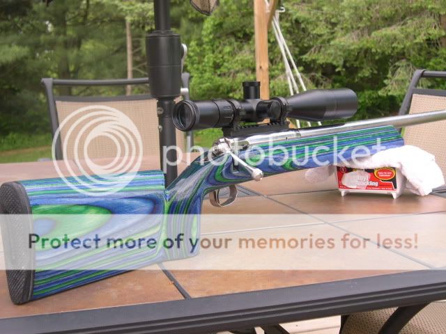

I have a SSS HBR stock. Not the LRBR, the HBR is heavier toward the butt of the stock, which is what you need. It is thicker around the action and also the whole buttstock is thicker.
One thing about it, you wont be disappointed with Freds work. Do yourself a favor and finish it using automotive clear. You will not be sorry. I still have to wet sand and buff mine.
