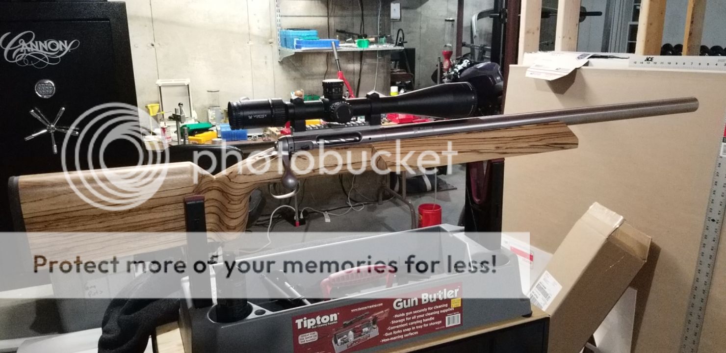

The bolt lift definitely isn’t anything like that of a custom action but neither is the price. I had @Grimstod from this forum do his version of a bolt lift kit as well as bush the firing pin and fill the ejector hole. Still not in custom territory by any stretch but The bolt runs as smooth as any factory action in my safe. Definitely not clunky IMO.
I can’t speak for ejection since had the ejector hole plugged. I don’t compete and don’t like to fling my brass out to bounce off the bench onto the concrete. It does extract just fine though.
All in all I’m pretty happy with the build although I do wish it had Jewel, B&A, or a Timney trigger.

Who made your stock ?
It looks great. Woodworking definitely is not in my wheelhouse. I have a ability to fix broken mechanical things some electrical work and a real good knack for pissing people off with out trying.:D
Woodworking no...:oops:
