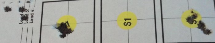

I have the Savage Long Range Precision in 6.5 creedmoor too. Here is the load I used on my first trip out this year to test:
41.5 gr of H4350
Fed 210
Hornady Brass (2x fired)
140 Hornady BTHP, Cant remember the bullet seating depth. I have written down somewhere.
Remember to work your load up from a safe starting point from a manual.
1st three shots in upper left were sighters. Then two five shot groups. (100 yards)

I also have a 12lrp in 6.5 creedmoor. Here is a photo of my ladder testing for it.
New Hornady brass, Federal 210 match primer, lapua 139 scenar.
H430 powder .010 off the lands.
I went with the 42.2 load @ 2824fps.
