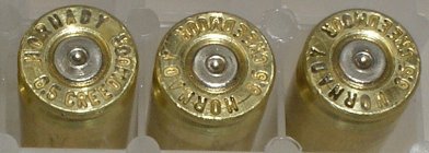

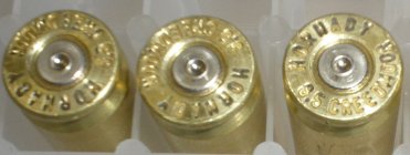

I have been working up a load for my 6.5CM. I got up to 42.8 gr of RL-17 with a speed of
2908
2899
2887
Here is a picture of the cases
http://www.websitetoolbox.com/tool/view/mb/file?username=6mmbr&id=668356
http://www.websitetoolbox.com/tool/view/mb/file?username=6mmbr&id=668357
I can live with 2900fps and if the brass look OK I'd be happy
Scott
3gun,
What bullet and primers are you using? At 42grs of Re17 I am leaking Wolf LRM primers with 140VLDs. Yours seem to be fine, maybe some cratering,which I have yet to get as the case will leak first).
Thanks
John
How many times have you reloaded those rounds. My primer pockets would be toast with the primers that cratered after just one time. I got up to 43.2 g h4350 with 142 smk's...once.
