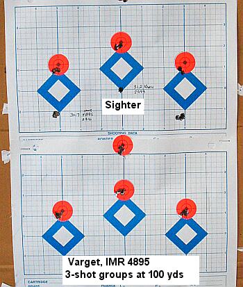

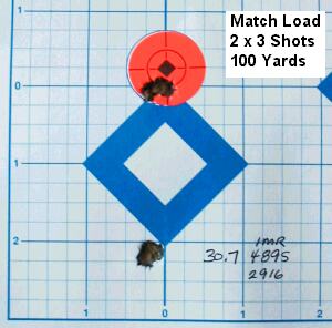

Yes, absolutely--3 shots ain't 5 shots. But this was with a 2.5" rounded fore-end field stock on a $40 rest, shooting 9 different loads with two different powders.

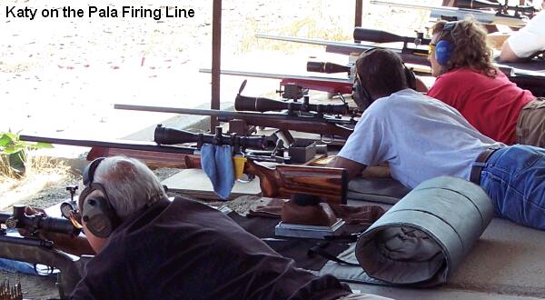

We've done a story about a husband/wife team that shoot at Pala, Katy and Don--perhaps you've met them. As you saw, shooting silhouettes is a lot of fun--but yes, you need an accurate rifle. At my club most of the top guys switched over to 6BRs and 6BR improveds after seeing how that Savage shot. Our club champ, John Southwick, definitely improved his scores after he switched from a 6-284 to a 6BR. He may give up a little in the wind, but the 6BR had much tighter vertical, day in and day out. We'll see if the 6-6.5x47 Lapua can be better. We have one being built for the site right now on a BAT MB.
Here's the Pala article: http://www.6mmbr.com/gunweek033.html
