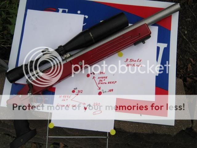

Pic of the build.

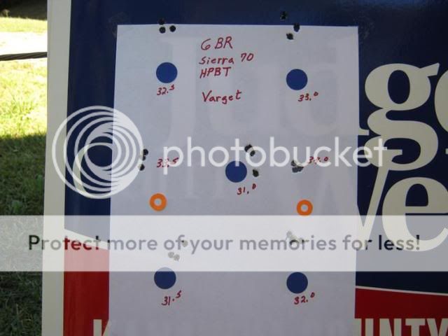

Pics of some Load-D
I pulled the bipod from the pistol and shot a couple groups using a rifle rest front and sand bag back. Even with shooting into the sun with a weak sore arm things got way better. Now I'm back to square one and will start Load-D again. I dont think this pistol likes a bipod!
These are 4 shot groups at 100 yards.
This group measures .248
Hope the elbow surgery goes well, David. I'm a big fan of Varget, especially in the 6 BR. In my experience (with rifles) I think those 33.5 and 34.0 gr. with the 70-gr. Sierra (or even better, 68-gr. Bergers) is going to be your "killer load".
Not sure what you've done with seating depth, but I'd like to see you try some at -10, -5, "at", +5 and +10 in the lands. The first thing to look for in early load testing is a group that is concentric and the 34.0 Varget load meets that criterion. Now, the H335 loads look good, though not comparable because they were shot off a different rest set-up. They may be work looking into, but I do not have sufficient experience with H335 to be of any value. With my Varget loads, I get the best consistency with CCI 450 primers.

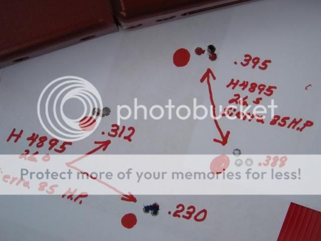

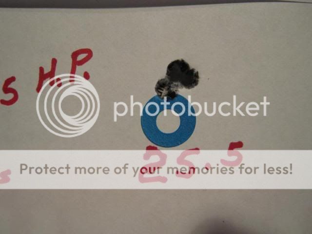

I had a few loads left and went to the range today. The bottom and bottom left I shot. A guy there had never seen anything like this pistol so I let him shoot the top and top left groups. For have never fired this gun he did pretty darn good and his loads were .5 heavier than mine could have made a little difference. All were 3 shot groups at 100Yards and windy. My best was .230 I think this ole gun is going to be some fun!!!!!
Finished this April.
Personal stock design and finishing.
Gunsmith: Eric Wallace "Crow Mag."
6 BR 20" Krieger; 1/13.5 Twist; Bat Action; Jewell Trigger; 24x Leupy.
Weight 22 lbs. (4) lbs of lead shot added to handle and base for balance.
