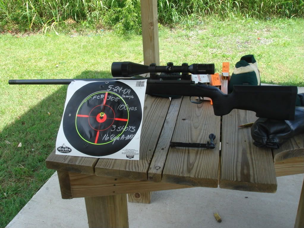

A picture of my stock Savage 308 shooting HSM 168 A-Max ammo
