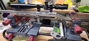

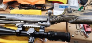

Here is a dual port in a FTR stock. 3.4 spacing. Newer actions are longer spacing.
Didnt realize resurrected from 11 years ago.
