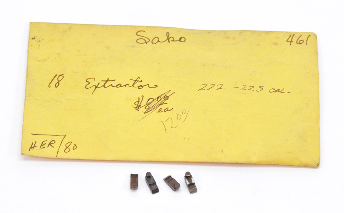

Anyone know where I might buy one or get mine replaced??? Best way to describe it is its kinda long and skinney. LOL, not a very professional description.
Could be wrong but the Sako Gun Parts extractor appears to be for the A1 action and not the L461.
Mine looks different than the one in the picture. I tried to post a picture of mine but it says its to large to post. (Still working on that.) I sent an email to Midwest Gun Works about repairing mine and they said no parts available. I Google searched yesterday and didn't have much luck . The extractor works most of the time now, its just not reliable and aggravating when it doesn't work. Looking at the claw part of the extractor, you can tell its going to 100% fail before to much longer. This is not a collector quality gun so how its repaired is not a big concern as long as it works and looks decent. From my searching, I guess mine is considered a "long" extractor. I also have found out they are scarce as hens teeth. Could a modern style extractor be installed? I think there would be some open space under the new style due to length but would that be a problem? Its a 223 Win.

I'm kinda in a pickle. Looks like an original part is out of the question. An M-16 extractor looks considerably longer than a Sako. I wonder if converting it to the M-16 is feasible? I thought about a complete new/used bolt assembly. LOL, what he wanted for a used bolt was just a little less than I got in the rifle, so that idea went to the bottom of the list.
The L461s /A1s and 491s I've seen don't have an extractor like that. Is that a really early one? Does it have bofus steel stamped on the barrel?
On the L461s and Vixens, there were long extractors and short extractors. You have the long version. If it's a 223, the one that Zastava uses in their current M85....which was formerly known as the Interarms Mini Mark X, aka: the Mini Mauser....is the same thing. With the exception of the bolt shroud, the bolts on the Zastava/Interarms are a virtual copy of the Sako L461 bolts.
It's #5 in the diagram, part number 107257. I bought a couple of these as spares from them not long ago.
https://zastavaarmsusa.com/product/sporting-rifle-lk-m85-parts/
The rifle has a custom barrel and it does have the long extractor. From what I have found searching the Zastava extractor is out of stock everywhere also. I tried to put it in the cart and it wouldn't let me. Seems the word got out they would interchange and now they are gone to.
