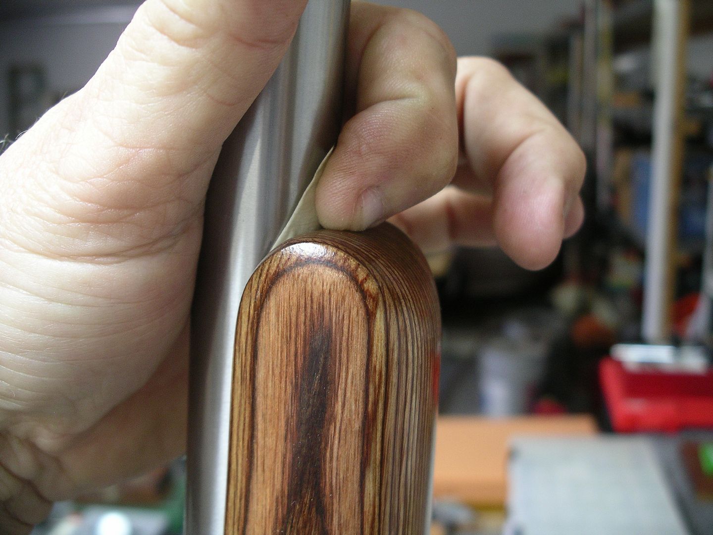

Quick, simple bedding check:
Place your finger firmly at the tip of the stock, now loosen and tighten the guard screws. If you feel any movement, your rifle is out of bed.

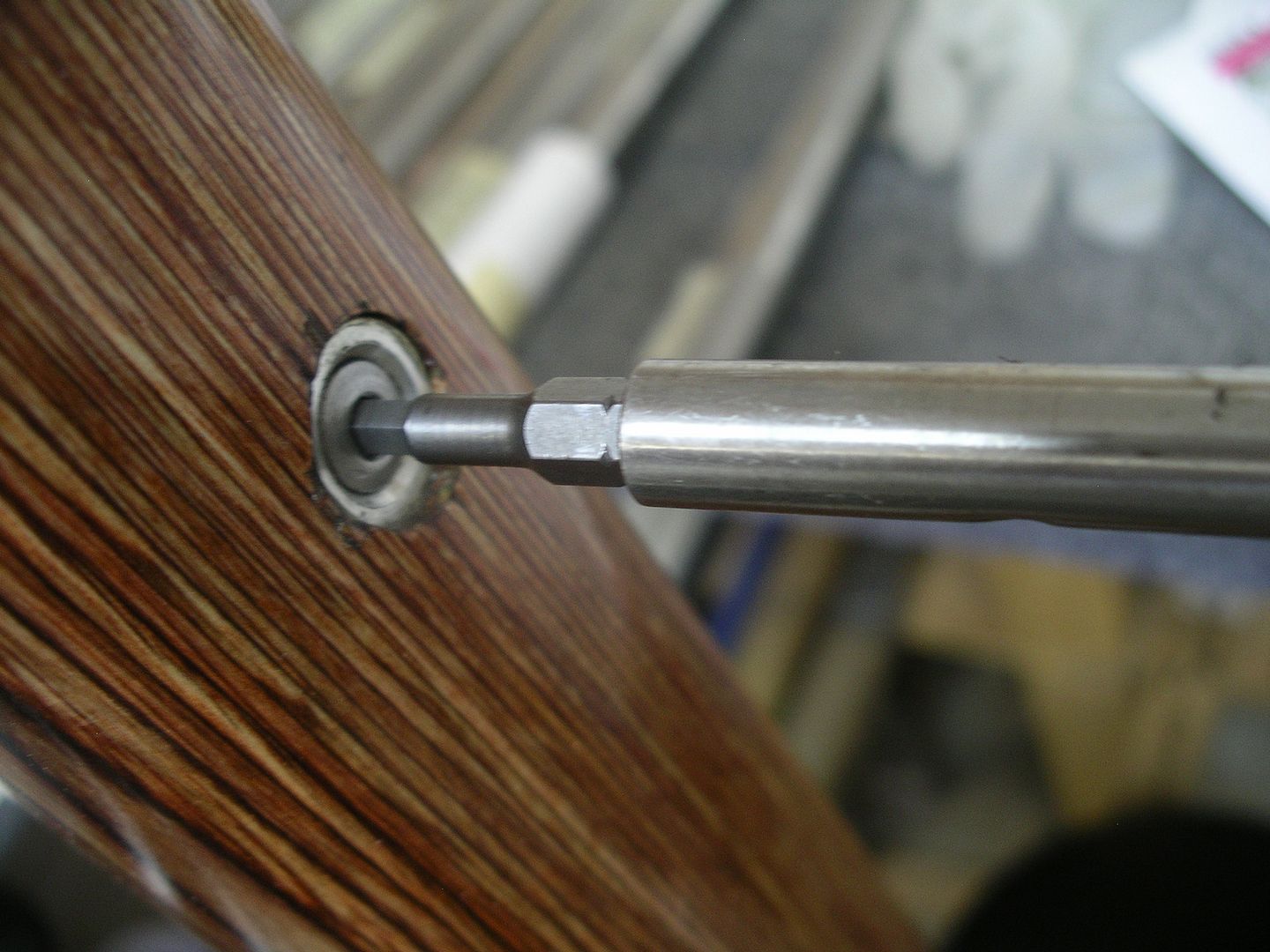

Turned a model 85 in 223 from a one inch shooter into a half inch shooter, with pillars & bedding. Waiting for good weather to tune load.
Sounds like I've been chasing a unicorn. I belimg003.jpg ieve that I have found the load. What's going to happen after 'pillar-bedding'~?
