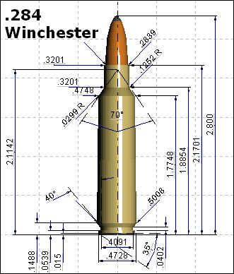

The .284 Winchester has a very odd history. It was first developed by Winchester in 1963 to fit their short action Model 100 autoloader and Model 88 lever action rifles. The idea then was to compete with and rival the ballistics of the 280 Remington. In order to do so in a short action rifle the case needed greater powder capacity than was previously available in any short action rifle. The case has an expanded width of .500” at the web while maintaining the .308 Win bolt face diameter of .473”, creating what is refered to as a rebated rim. The near absence of case taper, along with a very steep 35 degree shoulder produces,according to the books) 66 grains of powder capacity. This approaches the 68.6 grain book capacity of the 280 Remington, the 67.4 grain capacity of the 270 Winchester, and the 68 grain capacity of the 30-06.
The .284 Winchester fell by the way side shorty after its inception along with the model 88 and model 100. That is however, until wildcaters realized its potential and began both necking up, and necking down the short, fat, sharp shouldered case. Recently the 6.5X284 Winchester has gained much popularity with long range benchrest and F-class shooters. So much so that Lapua is now manufacturing high quality 6.5X284 brass.
Caliber Selection; many nay-sayers
With Charles Ballard’s National 1000-yard F-class victory with a “strait” .284 Winchester, there has been renewed interest in the original .284. See his Purple Haze: http://www.6mmbr.com/gunweek088.html. A .284 single shot on a long action throated for long VLD bullets is an extremely efficient and accurate cartridge, as Ballard and others have demonstrated. People are now actually necking up 6.5X284 Lapua brass for 7mm projectiles; oh the irony. However, there are many perceived negatives towards a .284 built on a short action receiver, as it was initially designed. To begin, even relatively light 140gr bullets, seated to a maximum 2.80 COAL, have bases that project below the base of the case shoulder by approximately 1/8”, reducing available case capacity. A 160gr Nosler Accubond’s base sits a full 1/4” below the base of the case shoulder. When bullets are seated to the maximum COAL of 2.80, the bullets ogive is actually below the case neck, which makes measuring cartridge length from base to ogive impossible. Furthermore, many people believe the sharp 35 degree shouldered case poses feeding problems. This is the steepest shoulder ever produced by an American manufacturer. Secondly, the rebated rim is thought to be difficult to feed from a magazine that is designed for the narrower .308 cartridges.
