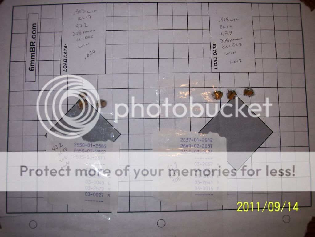

I've been shooting the RL17 and the 210/208 combo for a while now, too. Bus, what is the Varget load that you are shooting? I've lately been shooting the 208 at around 48.5 grains and have had no issues. I also shot the same at 50 grains, and that was fine, too... in the winter. Everything that I have tested personally or read, folks are shooting anywhere from 46.5 to 48.5 without any issues. I never gave VARGET the fair shake I should have. I've got 8 pounds of it on the floor... duh.

I haven't nailed a specific load down yet for the 208s, as they seem to me to be a bit more picky as opposed to the Berger 210. Here's some that I shot the other day.
