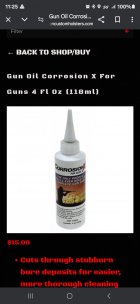

Best stuff I have seen. If you can get a pan where you can submerge the object.
