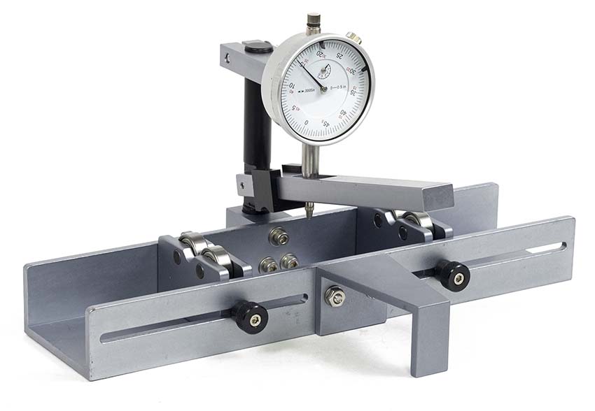

If the chamber is concentric to the bore(shapes sharing the same center) how does a few thousandth run out matter? And run out would be half the neck clearance after chambering?
My concern is that chambering a round with large runout will correct the bullet angle, but in the process it will alter the bullet pull force (by deforming the neck) which is known to affect performance.
Runout as an issue isn't about bore alignment and/or neck tension, and that's easy to prove yourself.
You won't see affects of runout until the upper case presses with considerable force against it's chamber wall. Basically, when you chamber a banana, establishing an abstract pressure point.
On firing, that case snaps to unload one side and ping the other side, sending an offending vibration back & forth the length of the barrel. This is a problem because it's different than vibrations are otherwise.
Typically we can get away with around ~5thou TIR before seeing it on target.
That's a lot of runout, even for a sloppy chamber.
With a tight chamber (not just with necks), ~2thou can be a problem,, but tight chambers do not produce bananas. They produce very straight cases.
If you run a tight chamber and sloppy sizing,, enough to cause ~2thou TIR,, then you'll be reaching for a looser chamber -to shoot better.

If neck tension is a causal factor for accuracy in the discipline you shoot, then run-out of a loaded round is part of the puzzle. If neck tension is not "that big" of a consideration, then no worries for you.
If your loaded rounds are out just a tiny bit, then you are likely good. If they are out far enough to get straightened in your chamber, you could be changing the neck tension a tad when straightening the round?
Several years ago I asked the same question on this forum and received a multitude of answers. I actually was expecting the "guru's" to give me a unified and single answer. As an example, "X amount is problematic, less than that, no worries". That is not the answer I received and I set out to do some testing.
After ordering several sets of dies and using 3 different presses, and spending a plethora of time adjusting this and that......... I went to the range to test.
1.) Jumping bullets...... I just could not see a difference if less than .005" runout, however I did not test jumping very much.
2.) Jamming bullets, less that .003" you will very LIKELY have no worries. Less that .002" and you're golden. I tested this with actual die induced runout (the best a die and press could produce) and with intentional runout (me corrupting the system to make matters worse), and with rounds I buggered up making things worse. The worst case always shot like I was slightly out of tune. A .010" runout round nearly always landed out of the group.

I have friends that check every round prior to a match and the straightest rounds are the record rounds. The banana shaped rounds are used for sighters and such. I built a system based on my testing and stick to it, but I check all the time. Unlike many folks on this forum, my concentricity gauge gets used plenty.

Generally, fired cases are pretty straight. If they become crooked it is in the sizing process. Having a concentricity gauge lets you look at the results of sizing, with an eye toward improving your equipment. I have learned that there are two things that work to improve how straight your sized brass is. If you are running a bushing die, the SAC bushings produce straighter brass. I have seen it. The other option, that produces outstanding results is using a one piece die that has a neck ID that gives the desired amount of neck tension without any expanding.

On the subject of intentionally making a round crooked, I have an H&H concentricity gauge, that is designed allow straightening of loaded rounds. Using it I bent a loaded round (for my ,262 neck 6PPC) so that it had .0035 runout. The bullet was set to engage the rifling, which is my usual practice. I chambered the round, unchambered it, and measured the runout, which was .0015. Years ago, somone who was an experienced short range group shooter told me that as long as rounds measure under .002 for runout that the differences could not be seen on the target. At the time, my usual runout was .0015 or so. None of this will make up for tune or a misread set of wind flags. IMO very small things only become important when match conditions are perfect.
About 15 yrs ago i was shooting one afternoon next to an older gentleman who was a BR shooter. He told me he’d experimented with runout and he couldn’t see the difference on the tagget if it was less than .009.
I’ve personally never experienced a problem that I‘d attribute to runout. If I looked long enough I can probably find my runout tool, but once I figured out my runout was usually <.002 with no special effort it went to some dusty corner of my reloading stuff.
It gets dragged out the first time I prep brass from a new barrel.
Is this product still being produced? A quick web search looks like web site that is dead and an end dated FFL.
Nope, not for a long time.
I believe the basic tool was originally designed and produced by an archery company. I think they sold them to straighten arrows?
