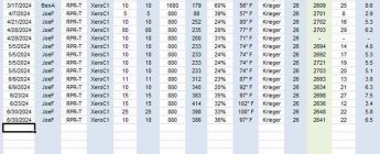

Like Dave M., I consistently get single digit SD's 5-8 fps. for both my RPR's (.308 and 6.5 PRC). Whether it's the factory muzzle brake or a tuner-brake mounted, I find no difference. Note, I find some powders tend to produce the lower SD's that other powders, as well as which primer I'm using.
Below is an example from my .308. The SD's are in the far right blue column and the white column next to that are the ES's. On the date 4-28-2024 you can see 80 shots taken and chronoed, which was with some virgin Alpha brass, showing an SD of 6.2 and and ES of 29 fps. IMHO, that's pretty outstanding for 80 shots with virgin brass.

The reason I ask is that I have consistently gotten single-digit ES for multiple Tikka T3x and Blaser R8 barrels, but I just can't seem to get the RPR down there no matter what I try (and I've pretty much tried everything).
Hmmm??? You realize the ES's are not the same as SD's? :rolleyes:
It could have something to do with the differences in their ignition systems, like having to do with the bolt and firing pin spring . . .???
I've gotten ES's and SD's low like that in you pic for 3 shots, but defiantly not consistently.
You are showing a 3-shot group. Three shots are not statistically relevant.
Shoot that Tikka or Blaser 20-50 times and then calculate the ES and SD. I am willing to bet my next paycheck that neither one of them will have a single digit ES.
