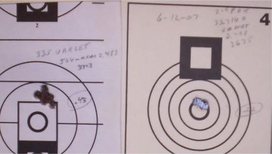

I'm curious, for those of you who've had varmint rifles built on the Number One, what sort of repeatable accuracy are you getting? I'm sure the Number One can deliver an occasional sub 1/2 minute group but can it do it repeatedly?

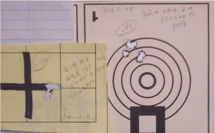

I would say yes they can. Of course thats after you find a good load and conditions are condusive to good groups. The two groups in this pic are from the first rebarrel that Mark did for me. Shilen #7 14" twist .224 chambered for my .219DW PDK wildcat. It uses a 30-30 case shortened to 1.900 with a 35 degree shoulder and holds about 35 grains of varget or N140. For ultimate accuracy a PPC or BR case would probably be better, but I like 30-30 cases so that's what I use. The right group is the best that I've ever shot with a No.1 and the left group is more typical of what it would shoot consistantly with good conditions. All my group shooting is done off a Harris bipod and rear sand bag because that's the way I shoot PD's. My No.3 with the Shilen #7HV 8" twist barrel in the same chambering is my first fast twist barrel. I'm shooting 75gr A-max with 34.0gr H4350 and getting groups in the .4's at 3200fps. It has really extended my shooting range with many hits past 500 and a best last June in Montana of 915. The other No.1 and No.3 are my .204 Wasp wildcat. Both the Krieger and the Pac-nor barrels are 11" twist and both like the 39gr SBK. Both shoot consistantly in the .4's with several groups in the .3's at 4000 fps.

Very impressive groups. It looks like both you and Mark. Penrod know what you're doing!! I gave up on the idea of a Number One based 22BR and went with an M700 based custom gun that isn't quite done yet. Hope it shoots as well as yours.

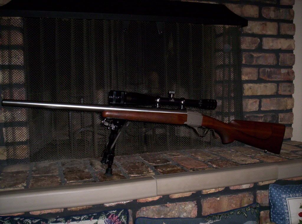

Have you any idea of the heaviest barrel a No. 1 would handle? I have a HV profile on mine and the gunsmith had to turn it down a fraction to clear the hanger arm underneath, then its a straight taper to 26", but I've wondered if it's marginal on such a small tenon. I guess the old Sharps and Rolling Blocks had long heavy barrels, albeit with a big hole down the middle!

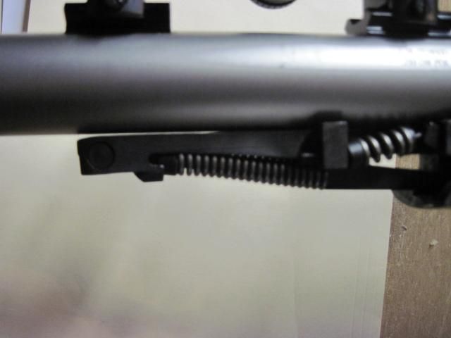

The Shilen #7HV is the heaviest barrel that I've used. I don't remember reading about anyone using a heavier barrel on any of the forums that I visit, but I'm sure someone has. The #18 Krieger and the Pac-nor Target Weight are 1.200 dia. for 5" and mark turns the #7 Shilens down to 1.200 dia. I use two #85 Weaver bases about 3.31" apart. The weight of the rifle would bend the forearm hanger to touch the barrel, so Mark heats the hanger and bends it down about .040-.050.
If I ever decide to rebarrel to a cartridge that has more recoil, I will probably go back to a .875 dia and use a brake rather than a heavier barrel. I have a Vais brake on the shelf that was on another rifle and it works very well.
Not a very good pic, but you can see how much clearance there is between the hanger and the 1.200 dia barrel.

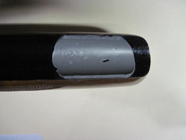

I've always made plenty of clearance between the forend and the barrel. About a year ago I decided to try a pad in the forend. I tried silicone caulk since I had it on hand and it would be easy to remove if it didn't work.
After a couple of range tests where I found that three of the rifles liked the screw only light tension and the other shot better the more I tightened it. The groups aren't any better than before, but seem to be more consistently good. I was down most of last summer after knee surgery and didn't get to test as much as I wanted. I did wait until after my Montana PD trip to have surgery.

Back in the mid 90's I had a #3 rebarreled to .219 Wasp by another gunsmith. He turned down the Shilen #7 barrel to 1.160 but didn't know to bend the hanger. There was about .015 clearance between hanger and barrel until you put the weight of the rifle on the forend, then it bent and touched the barrel. I stuck a piece of thin cardboard between hanger and barrel and it shot great. The load on the left with 50gr NBT shot great for about 3000 rounds. After the throat was gone , it shot the 55gr V-max fairly well until I rebarreled it to .204 Wasp after 6000 rounds.
