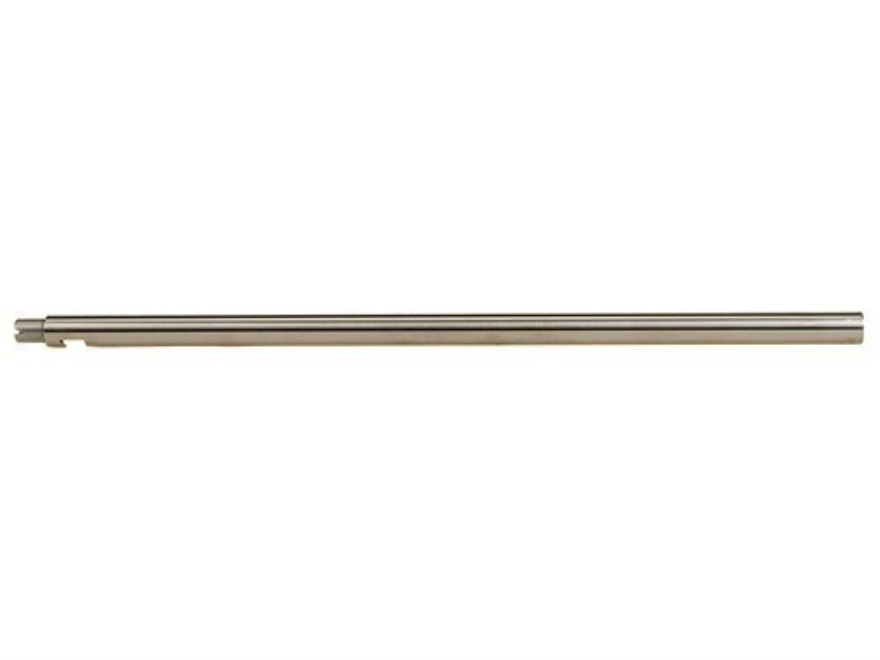

Or put one of these bad boys on:

I've never seen problems with a mach2 tumbling. I'm curious what you'll find out. Ruger quality control can be a bit lacking at times. Maybe the bore is slightly oversize. I'd be tempted to slug the barrel.
