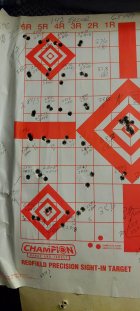

This is the way i do it. I use the 90° lower left "L" for a hold, setting my scope so poi is in the square. 2 shots. 10 loaded at that charge.
I'm looking for the best group. I find it then play around that with tuner then seating depth.
The Garmin added the ability to see the speed without giving up poa shooting through a conagraph.
100yrds
I wish I was a lot younger.
