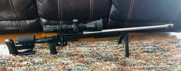

Here’s the medium height ARC M-10 rings with an 56mm athlon on a fairly heavy profile savage barrel nut setup. 1733327708996.jpeg

In most cases mediums will work on sendero/bull barrel tapers. This pic shows 56 mm objective on sendero taper.

Measure the scope rail height above the barrel and add a ring height measured at the ring centerline, then scope body objective diameter/2. If this number is a negative number, the scope is not clearing the barrel. If this number is a positive number, the scope is clearing the barrel by that amount. Be sure to include any lens cover or flip up cap dimension with objective diameter measurement. Also, if you are shooting a rail with built in MOA, you would have to allow for that slope in the measurement. One of the smart guys here can give you that calculation.
