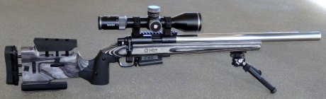

I have both - Rim X with Benchmark & Kreiger barrels. Bergara with Kreiger.
The Rim X action is smoother but I have no complaints with the B14R action. Both are ultra reliable when set up properly.

thanks great to know. What stock is that one on the bergara ??
Just put my Tikka T3 into one of the MDT Charcoal.

Did you have to modify the bedding or is the B14R a Rem clone action or a Tikka for that matter?
That is the only two types actions that they list for the inlet of the stock.
The B14R is a Remington 700 short action clone and is a "drop in" with the MDT stock. The Bergara AICS pattern 22LR mags also feed perfectly (for me) in this stock - Something to consider when choosing a stock for any of these 700 foot print rim fires as mag height/angle is critical.
I did make a set action screws for this set up so that I had maximum thread engagement without bottoming out on the barrel tenon.
