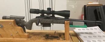

I ended up getting the Kinetic Security Solutions ATS for my Bergara B14R. Did some testing with SK Rifle Match this past weekend and it definitely makes a difference. I found a couple nodes that work well. Now I need to work on my rest setup so I'm not the problem with fliers.
