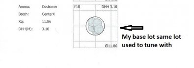

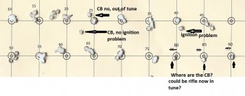

here is an example, the rifle that shot this tuner target is a factory Anschutz that is 45-years old. without a tuner it can shoot sub-.200 groups, but not consistently. after it was tuned and was tested at Lapua's Mesa tunnel it shot a 11.86mm 10-shot group oto that is 0.466 for 10 shots not 5
also I used 58 rds. to find that 85 setting. each group is 3-shots and the tuner was moved out 5-clicks at a time. this was 2 years and 11-days ago, since that time I found the setting of 90 to be the best for this rifle.

Lee, on your "tuning session" image what does "CB" mean?
CB=Cold bore flier. which that wasn't the case, the firing pin spring had to be changed and the bolt had to be what I called blue printed, so the firing pin has free movement. surprisingly after years of use the pin guides will wear in and if you take apart the firing pin assembly and don't put it back it can bind and cause ignition problems.
this goes back to tuning and being all part of the package, as I had mentioned in another post here.

for anyone that will make their first attempt to use a tuner, I would shoot some groups with the best lot for that rifle without the tuner. this will give a good base line for when you do put the tuner on and start to tune.
